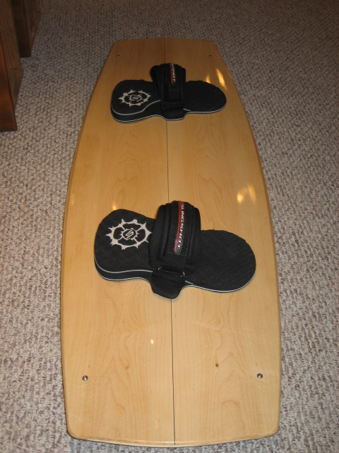

The top with the bindings....

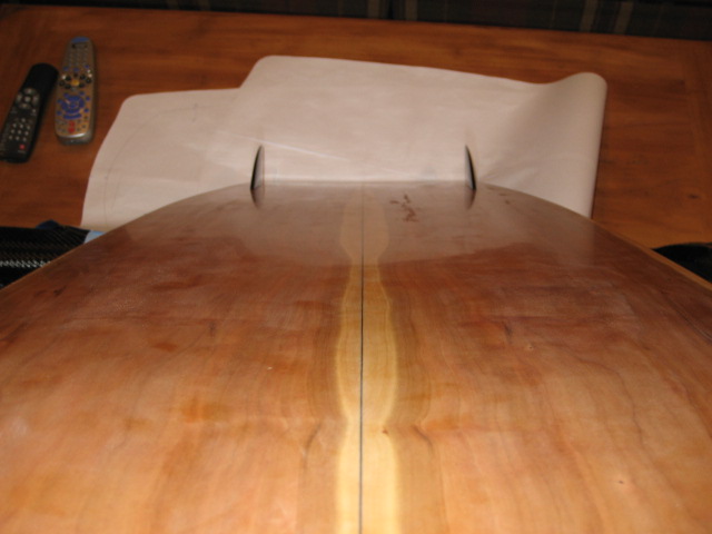

Part of the bottom...at the end are the fins.

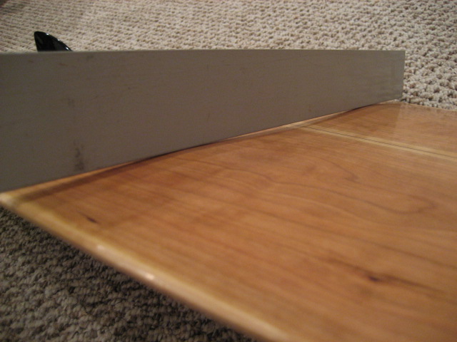

The interesting part of the design is that the bottom is concave...

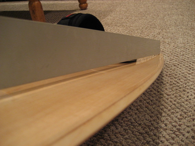

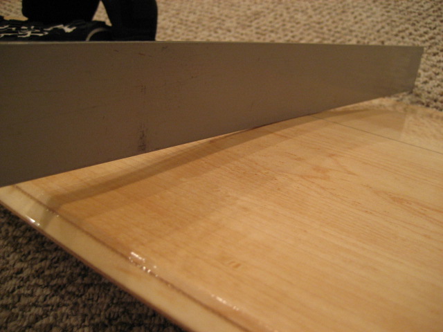

The top is convex...
And the whole thing is an shallow arc from one end to the other...
